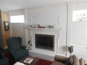

The home currently has a LP gas insert in the FP. Looking to rip that out and put something wood burning in. I've seen some setup's that have a stove in the fireplace and some that use an insert.
What are the specific pro's and con's with each? Unfortunately I do not have the measurements of the FP however I may be able to post a picture for reference.

Congrats to your (soon to be) new home. To figure out if you can use a hearth-mounted stove you will need to find out the height of the fireplace and the depth of your hearth. The way it looks you may need to partially recess any stove in the fireplace which may restrict your possibilities. You will also need to check whether your current flue allows a liner for a woodburning stove. A hearth-mounted stove has a few advantages:
- More radiant heat and less/no reliance on a blower to distribute the heat.
- Comparable stove models are often less expensive than the insert.
- Potential cooking surface in case of a power outage.
- Safer option with a prefab fireplace (as yours may be).
Disadvantages:
- Takes up more space.
- Requires a relatively tall fireplace.
- More limited selection.
Plus, many wives seem to prefer the look of an insert over a hearth-mounted stove.
I would suggest posting the measurements and some more pictures of the fireplace. In addition, the following info will be helpful:
Size of home? Insulation? Do you know the last owner's oil consumption during the winter? Are you planning on primarily heating with wood? Budget? Floorplan?
You will also need to get dry, seasoned wood if you want to burn next winter.

A little more background the fireplace hasn't been used for close to a decade per the current owner and no gas in the tank - I'm going under the assumption the insert is non-functioning.
Welcome. We'll need to know more about the fireplace to give good advice. Besides getting the dimension of the fireplace it will be important to know if this is a masonry fireplace with a masonry chimney. If it is, approximately how tall is it (one story or two)? How open is the floor plan and in particular this room to the rest of the house. That will determine the right size insert or stove. Both will work.

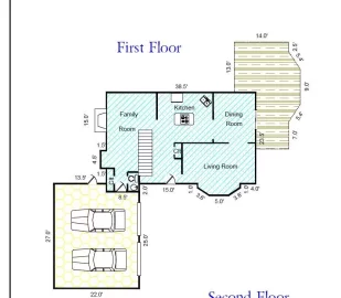

I'll see if I can scrounge up a floorplan.

Chimney's two story on an exterior wall. It actually needs some work as there was notable damage so I'm unsure what the makeup of the chimney will be on closing.downstairs floor plan is pretty open from what I remember...I'll try to get it sketched out.
Great, 2 story is good. It looks like a decent sized fireplace that may be able to accommodate a good sized insert. Regardless of heater you will want an insulated stainless liner connecting it and an insulated block off plate at or below the damper area. The mantel is a little close so that may be a factor for clearances. But a mantel shield can help mitigate that issue or perhaps go with a flush insert.
Looks like the heat will get upstairs pretty easily. The living room may get the short end of the stick without some assistance.

Can I rip out the existing hearth to floor level, put in a hearth pad and then install a larger stove (that will then fit in the fireplace)?
Really don't know what my options are. I would like to get a catalytic stove / insert however I'm not exactly thrilled with the painted white brick look so I'd like to rip the hearth out either way. Also wondering what ballpark labor would be for that type of job...would this be considered a major project?
Somewhat depends on the stove...
What you need to protect is the floor from 'pyrolisis' ?sp?.
Should be found near the 'minimum clearances' data.
So different stoves will indicate different R values and thicknesses of the material under the stove so one too many overfires doesn't catch the floor on fire.
The hearth pad is just to catch falling embers and such, not insulate combustible materials from the stove.

What kind of fireplace is it exactly? Does it have a metal floor and a steel pipe as chimney? If yes, you can probably remove the brick hearth in front but you won't be able to recess any stove in the fireplace without removing that, too. Essentially you would remove the whole fireplace, finish the space as an alcove and then you can put a freestanding stove in there. If you want to go catalytic, Blaze King and Woodstock would be two obvious choices. Do you have a pic of the outside "chimney"? Contracting that out won't necessarily come cheap and will be in addition to stove, chimney etc.
