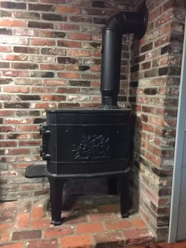

New member here looking for instructions on proper operation of this model lange stove. I just bought a house with a Lange model 6302A black wood stove. I am new to wood stoves and was hoping for step by step instructions on how to light and operate this stove properly. I saw this post and thought I might get some help from someone with the same stove. Thank you.
