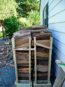

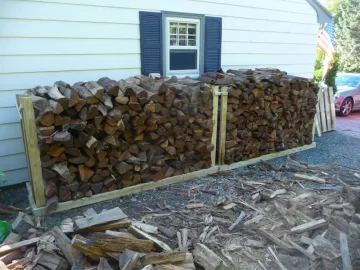

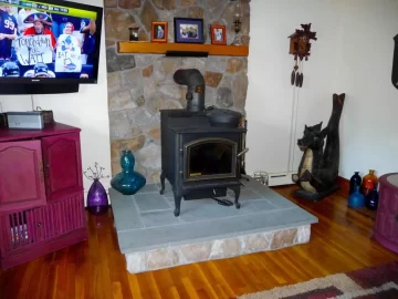

This is freshly delivered wood but it looks pretty good. I have about a half cord from last year as well. The stove is a 1999 Quadrafire 3100 Steptop (I've only lived in the house since 2007) .
Built the wood racks in the last few days, thinking about stain/painting them
Keeps the house real warm.
I need to get up on the roof and look at the chimney, I have a brush and pole set, so depending on how it looks I may end up calling someone to give it a good once over.

The wood doesn't show much checking. It would be good to resplit a couple of the splits and test for moisture on the freshly exposed surface of wood. If you don't have a meter, place it up against your cheek. If it feels cool and damp, it is.

You better test the moisture level in your wood. You want to split one or two pieces and see what the moisture reading is inside each piece....20% or less is definitely preferred but I have gotten by with wood just under 25% (not preferred). Getting two to three years ahead in wood will make your life with the woodstove so much easier.
Very good looking wood stove install, and nice looking wood piles.
Why don't you put a roof on your wood pile? A piece of 26 inch roofing tin.
Yeah some doesn't look too well seasoned. But some is nicely checked. So I will check it when I can get my hands on a maul and a meter. Thanks for reply's all!
A little tip on that wood to help it dry a little faster: leave a bit more space for airflow between rows, and between the stack and the house. I used to stack three rows tight together, and the middle row would always have some moisture, so now I single-stack with at least a foot between. (And when covering, cover top only, not sides.)

If possible, I would move that wood away from the house. It will attract many critters and bugs including termites. I keep my wood as far away from the house as possible. In the Fall I move it all to the wood shed which is still about 50 feet away.
