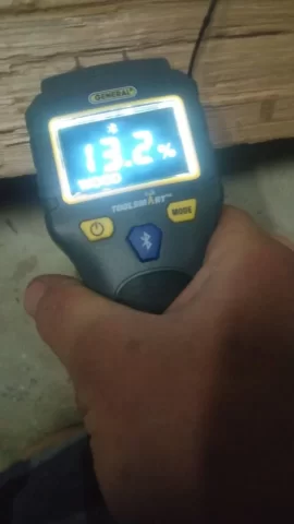

So this is another piece of the dead standing red oak I cut almost 4 weeks ago. Had it in house for 2 days.(broken image removed)
Anyways moisture reading was 13.2%
Well cool! That standing dead oak had really dried down. I thought that moisture reading would go way up once it warmed up. Looks like that is ready to burn - in the stove it goes! ;-)

Figured out how to post pic
