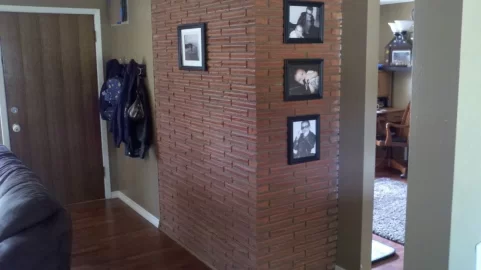

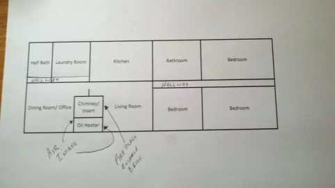

Wood supply is your normal up here in the Northwest. Dry Alder, Maple, and Fir. My house was built in 57. It is a ranch style house with a 2 car garage. The dining room/office is where the insert is and the chimney goes up through the center of the house with the backside of the chimney bricks exposed to the living room area with the kicthen to the back of the living room. then the 3 bedrooms are to the west of the living room. I will try and draw it up cause I know pictures help.

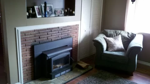

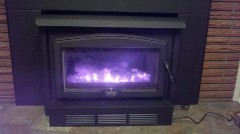

Maybe this will help.

It was the 4th time I fired it up and it was a reload. I did stuff her pretty full with some dry maple and alder. And the stack is right around 15ft tall. I had my local dealer do the install on this stove. I may be calling them already as my blower is already making a bunch of rattling noises.
EPA stoves don't close off the air completely. The fire may build in intensity after the air is closed off. As the air control is shut down, the fire should change in that it will burn less at the base of the wood and more at the top of the firebox in a lazier, wafting flame. There often is a vivid amount of jetting coming out of the secondary manifold during this latter phase as air is injected at the top of the firebox into the unburnt wood gases.

For more even heat in the house put a table or box fan at the far end of the hallway, on the floor, pointing toward the woodstove. Run it on low speed. It will blow the cooler air down low, toward the woodstove. This air will be replaced with lighter warm air from the stove room. Running this way you should notice at least a 5F increase in the hallway temp after about 30 minutes running.
