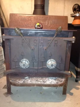

Just burning off the new paint on this old rust bucket someone gave me. These old stoves are awesome, it's cruising at 620 stove top with a 3' chimney. I just can't get the doors hot enough to bake the paint really good. If anybody wants to know I didn't use any primer or anything like that just paint. I used a grinder with a flapper wheel and a wire brush by hand to prep it. Then rinsed off with water, dried it with my compressor. Rust-oleum specialty high heat ultra paint semi gloss. Paint seems to be sticking good after 45 mins.

Before
