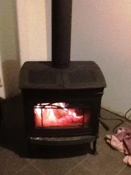

Figured I should add a pic. Forgive the crappy camera phone picture. Better pics and review to follow once this computer is fixed.

Looks good. I don't hear ya complaining, so you must be enjoying her now?
Living up to your expectations? What burn times are you getting?
Its working excellent.
Throwing a ton of heat in this -23*C weather. House isnt super hot, about 21*C, but Im not complaining. With the old stove it would be closer to 12-15. When it was warmer outside like -10*C there was so much heat I was kicking blankets off the bed. That hasnt happened in a LONG time!
It burns the wood up to a fine ash where the old one would leave lots of coals.
Soaks heat up like a sponge and radiates it for a long time. After about 9-10 hrs the stove is still at about 200-300*F STT. when the outside temp is warmer. Im riding it a bit hard now because of the cold, and trying to keep the STT up into the 500-700 range.
Typical cruse temp with the draft basically shut off is 625-650 STT. Nice secondaries.
