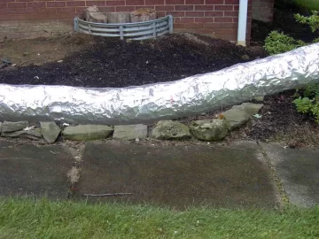

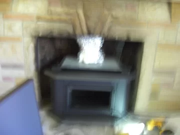

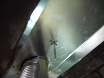

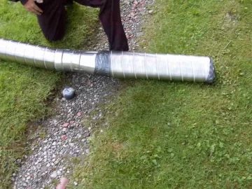

Here are some pictures I took during the install. The last one is bad but it shows insulation covering the liner as it enters the stove and there was a screw clamp under this. If I need to I'll pull the surround but I think I will have to inch the stove out because my stone on the hearth blocks the removal. He has two metal plates under the front which I would assume are for leveling the stove and if I move it will I screw things up? The second pic shows the damper block off plate and yes there is insulation above it (part of a kit.)

The metal or foil tape was used to secure the insulation so I don't think that was as big an issue as the duct tape.
Call the guy and tell him you have been looking at the pictures and wondering about the tape. Ask him what it was for and what kind of connection is under it. Just make it a friendly question and I bet, from looking at the other picks, that he did a proper job and has a good answer. A guy that did that good a job on that block off plate didn't just duct tape that liner splice.

The pictures help. It does look like he was doing a good job. No problem if the duct tape on the pipe connection in picture #1 was only temporary and it was taken off before connecting the stove.
The pipe sections were held together with stainless steel rivets and the tape was used to prevent cuts when working around these areas. The tape was not removed however.
So, where does this leave me? Any further comments?
Thanks!
Light that sucker up. The tape is inside the chimney and above the block off plate. It will last about thirty minutes the first time you get that sucker cranking and it will be bye bye tape. It isn't gonna hurt anything.
