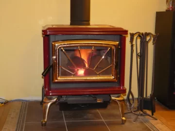

We have a 2 year old Spectrum Classic and are perfectally happy. It heats the 1100sq ft main level of our 1990 built home. As a relative newbe with wood it has been super easy to use, we love the red enamel finish.
  • [Hearth.com] New purchase
