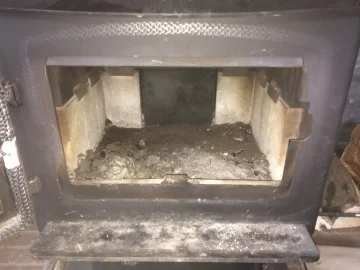

quick question for you guys. Does this door look like its leaking. Brand new stove this year, since they installed it i havent been sure about those pieces of white tape(?) on the ends where the gasket meets. I did the dollar bill test. (and have tightened the door a few times, right now it seems I cant tighten the bolt any more on the back of the handle. Dollar bill slips out with slight resistance, but can definately pull it out all the way. Any thoughts?

It looks like it is leaking a little where the tape is. And you will be able to pull out the dollar bill there should just be quite a bit of resistance
