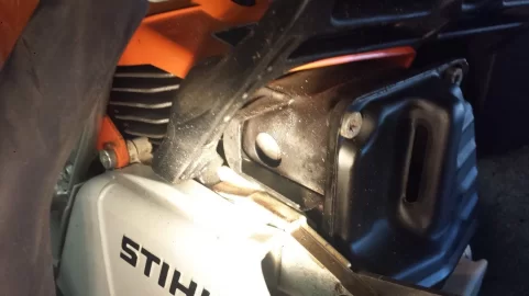

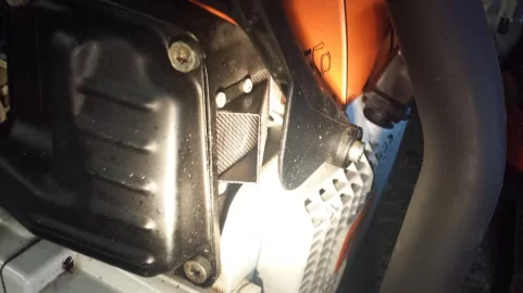

What do the muffler mods look like for this saw. Are they created by unbolting the factory cover, and placing in a new bracket with larger hole? Do you take out the baffling. I doubt I will be doing this but just wondering what they look like. Does anyone have a vido of a 290 with muffler mod?
Chain stays tight when set, my muffler mod was simply opening up the holes in the muffler and running it a little richer on the carb.
You can open the factory port, or add a second port, with deflector.
The big saws have a dual port cover option. I have the factory port (enlarged), then a second port w/deflector on opposite side, then the ported cover. Or a Tri-Port :cool:
And yes, it sounds very Good ;em

Why is no one just buying mufflers off ebay, modding them, then reselling them. I bet you sell a lot. Or just offer a kit that you could bolt on. Then if something does happen, just put the original muffler back on ;)
Because its so easy to do. Some muffs do have more holes in them than factory.
But here's the thing. I'd ur not mechanically inclined to mod it yourself or take directions here to do it yourself then you likely aren't mechanically inclined to tune your Carb either. Which will cause you to smoke your saw, or lock it up.

A muff mod causes your saw to breath easier. To more efficiently get rid of exhaust faster. Doing so will allow it to take in more air. More air at factory setting means it will run to lean at higher rpms. Its a 2 stroke lean is your enemy. The lube is in the fuel so you have to adjust your fuel for the increased airflow.
