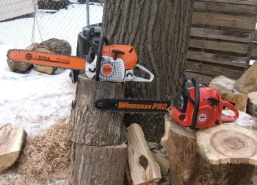

With the bigger powerhead, you can either gear up with your sprocket (8t instead of 7t) or lower your rakers a bit and take a bigger bite. I think that 18-20" bar is a good firewood combination on a bigger powerhead, especially if you're working with logs rather than whole trees. I just find that the time per cut is reduced enough to make the added weight and fuel consumption worthwhile.
Dolmar 7900(mufflermod)/20" and Stihl MS441(ported+muffler)/20" make quick work of logs and are still light enough to take out the larger branches. I've even run a 20" on my Stihl 066 when processing up trailer loads of 16-24" logs into firewood, but that actually starts to feel like overkill.
