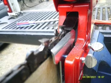

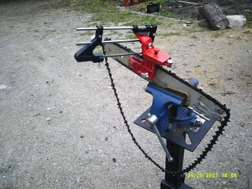

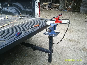

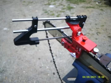

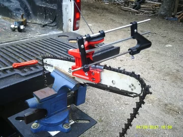

I was shopping for a new milling chain and ran across the Tecomec Deluxe saw chain sharpening jig. From the photos I noticed several features I liked over the Granberg jigs I already have. Namely that all of the adjustment screws are more accessible, the tooth stop is adjustable, the whole jig is much more stable, and the part that holds the file can accept a flat file, round file, or three angle file. I haven't used this jig to adjust my rakers, yet, but the instructions make it look much easier and more precise than any other setup I've seen so far. In the photos I'm testing out the jig on the chain that came with my first saw. The last time I took down the rakers "a few thou" less than the height of my cutters with my bar mounted grinder, I wouldn't suggest this technique for everyone. I look forward to using the flat file with the jig for future raker adjustments on other chains.
The only thing I don't like is the black plastic parts, but they do work well, better than the Granberg jigs!
