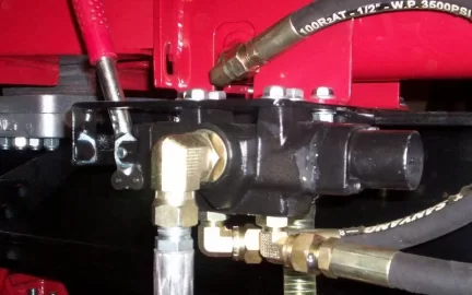

After my incident on Sunday with my new Northern Tool splitter, which was replaced with another new one, I hit another snag. On Sunday evening after I got the new splitter home I split one round to test it out. Monday I worked too late and never looked at it. Tonite after work I was dying to use it. Although dark, I grabbed a chunk of wood to split for fun inside of my shed. The control lever didnt seem to work properly. It wouldn't return automatically, the ram would stop just as soon as I let go of the lever. I'd have to hold it until the ram was fully retracted. I first thought the oil may be cold, despite being 50 degrees. So I let the engine run full throttle for about 5 minutes and repeated the process with the same results. It was then when I noticed some kind of greyish oil coming from towards the rear of the control valve, where 2 seperate pieces are joined together by 2 allen bolts. I tried to tighten the bolts, which were a bit loose, but this made no difference. More oil would come from this joint when more pressure was used to retract the ram.
I called Northern Tool, because I knew the store would close in 10 minutes. I talked to some guy who was familiar with the first splitter I returned on Sunday, due to paper in the hydro tank. I told him the trouble and said I would possible be returning the splitter for yet another new one. My three day return would expire today being I bought it on Sunday. So I needed for him to verify I made contact within 3 days. I told him I wasnt interested in returning the splitter but I wanted one that is without defect. He mentioned they could fix the valve. I told him I would settle for nothing but a new valve or new splitter. And I wasnt going to drop it off and drive back home, wait a few days for the repair, than drive back and forth again. Its almost a 60 mile round trip. But anyway I took a picture of the valve. Maybe one of you can tell me what you think the trouble is. You will notice the grey oil towards the right side of the control valve.

I wonder if there's a bad batch of these valves.
My splitter did that too.
It kinda also spit some oil out the end.
They sent me a new valve which I haven't installed yet.
I was able to get it to work better by rotating the cylindrical shaped piece that is attached to the handle.
What you are describing is in effect a pressure relief not a defective detent valve. If for some reason you finish the split but continue to hold it for maximum Ihydraulic pressure that pressure builds up and reaches a point where it blows off.. t happened twice on my splitter when my son helped me he did not know enough to release the valve after it finishes its cycle All I did ws to remove the larger nut check the o ring position and screw it back in the situation is corrected.. It will happen again and again till you learn not to keep holding the valve forward when it is done
even if you get a new one and hold it too long it will happen again Before you bring it back fire it up and move the valve and piston back and forth is it still leaking? If not then resume splitting
Your correct velvetfoot, the detent isn't working properly. As soon as I let go to the lever the ram stops moving backwards. I did call Northern again today and they said they have a new splitter waiting for me to exchange for this one. Lets hope the third splitter functions properly. I'd like to split some wood this weekend.
It doesn't make much difference because you are getting a new splitter, but for future reference, I think the detent pressure is adjustable, as well as the max pressure (it can be set up to the highest pressure produced by your pump). Your valve obviously has other problems, but if it was just the detent, that might be able to be adjusted.
Earlier you mentioned "auto return" - this may be a feature included with your valve, but my standard "Prince" valve just kicks into neutral at the end of the stroke (or if the detent pressure is reached while splitting a log, and I'm not physically holding the handle in position) I don't know of any right off hand the totally reverse direction - that might be a little dangerous if it did it unexpectedly.

I picked up my newest splitter on Friday. I had them fill it with fluid, before-hand because the one I was returning was also full of fluid, 8 gals. I timed the cycle before taking it back, it was 21 seconds. It is rated as a 13 second cycle-time. The trouble was the control lever wouldn't go back all of the way, it would only go about 1/2 way. Which makes me wonder if there was another wad of paper inside of the hydro tank like on my first splitter. Which could have made its way into the system and jammed something up. When I innitially fired up this splitter it returned properly, but was only run for a few minutes. The second time I was using it, is when the problem started. Something was keeping the lever from going all the way back.
