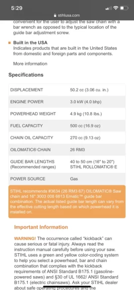

Have you tried running it with a 20” yet? Wondering if need me how it pulls. It’s funny, Stihl offers up to a 20” bar on the 261 but “recommends” a 16” per the website.

A 20” bar using 3/8” chain will be a load for a stock 261 but will pull it & most likely work it like a rented mule. A 20” bar using .325” chain on a stock 261 should be ok.
Keep in mind a lot of how the saw handles it is how you cut: are you heavy handed or do let the saw do it’s thing & not try to light saber it thru the wood.
Another thing is how your chains are sharpened & where your rakers are set.
A full chisel chain “ yellow label” Stihl chain is going to pull harder than a semi chisel safety/low kickback chain based on chip size & clearance.
There are a lot of variables other than just bar length that will affect how your saw handles things.
