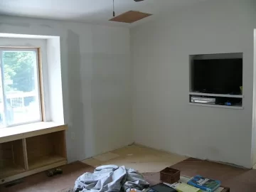

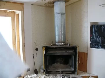

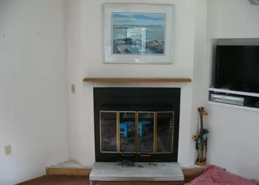

We’ve enjoyed burning in the old ZC fireplace for the last few years but the price of propane just trends up and CSSing a couple of cords of wood is getting harder for this old man. So in the ongoing reno of our beautiful mobile home we decided this was the year to install a wood stove and stop wasting heat.

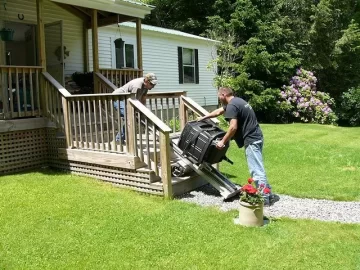

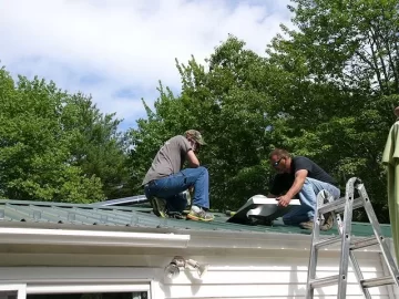

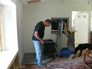

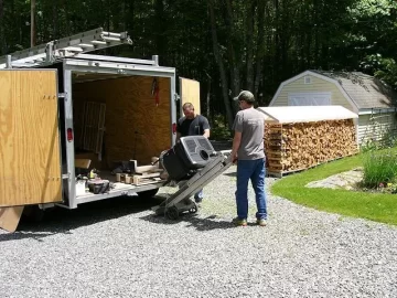

My end was getting the fireplace out and cleaning up the walls and ceiling and so on. The install itself was done by the stove shop. Very smooth and professional. About 15’ of pipe/chimney and the draft seems perfect. They also installed an OAK through the hearth to the crawl space.

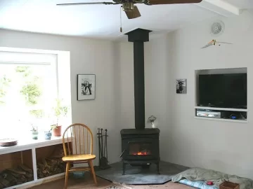

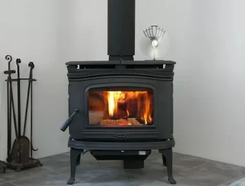

We chose the Alderlea T4 because the living room is less than 250 sq ft and we were afraid of being blown out by too much heat. We looked at a whole bunch of stoves but the size and convective nature of the Alderlea seemed the right choice. So far we’ve had about a dozen fires and all have gone well. It was 34 this morning so I lit the stove around 6, have reloaded twice – temp in the living room is 77, adjacent kitchen/dining is 73, bath and laundry are 72. I did put in two through wall fans which have definitely helped.

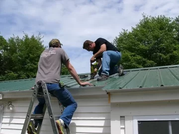

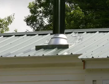

Hard to tell with the pic . . . but no roof bracket for the chimney? It appears to be over 5 feet tall coming through the roof.
The actual woodstove install . . . especially the last pic . . . looks wicked sharp. In truth, I thought at first the final pic was something from a brochure.
You're right it's 5' 3". They convinced me it wasn't a problem on our short 4 pitch roof and that the chimney support bracket would be enough. They did put snow guards above it. We'll see.

Nice stove, nice home and nice wood stacks. Enjoy!

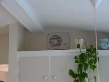

Nice pics! Love the stove and your wood stacks are super tidy - really like your covers! Also, any chance you could post pics of your through wall fans? Thinking we need some of those in our cathedral living room to vent the heat to the upstairs more efficiently.
The living room is pretty central in this 74' long mobile home. Adjacent on one side is the kit/dine room. Unfortunately, there are cabinets on the dining side so we had to go with a fan high up, pretty much over the stove blowing into the kit/dine. Not ideal but it does over time raise the temp in the kitchen.

On the other side of the living room is a hall leading to the bath and laundry. Here we put a fan down low (through the bookcase) blowing into the living room. This really does set up a loop - warm air down the hall, through the bath and laundry and back into the living room.

Id love to see a closer look at the flashing. Looks like a great installation.
The stove company had a lot of experience with both mobile homes and metal roofs which was part of why we chose them. I'm not sure of the brand of flashing but it's like this one - (broken link removed to http://www.icc-rsf.com/main.php?t=chem_produits&i=95&l=en)
