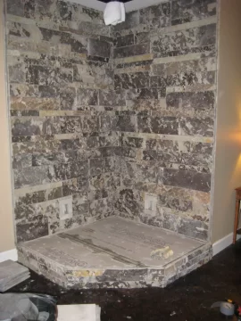

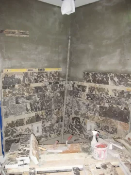

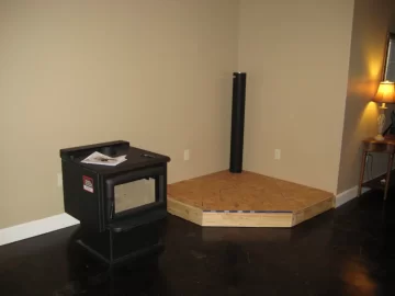

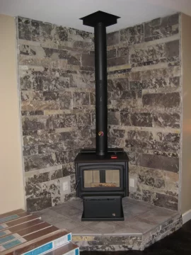

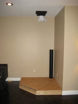

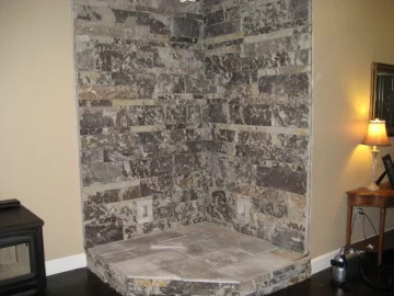

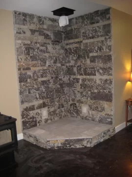

Bought my first wood stove about 6 months ago, been a long trip but I finally finished it.

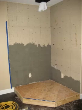

I had a chimney installed in my house, built a hearth, had the wall stoned (limestone from a local quarry), tiled and then installed my stove. Haven't lit it yet. I tried to put down a photo series here of the progress and finished product. I did some of the work myself and hired some of it out. I still have to put some trim on the outside edge of the stone but that's about it!
Hearth is framed with 2x6's supported with concrete blocks in between. Perfect fit.
Pretty excited. I have about a cord of dry wood but working on more. I'm going to use my stove for supplemental heat on extremely cold days and power outages. I may end up using it more if it heats my house evenly. The stove is dead center in my single level home (~2300sq ft) so we'll see what happens! I think I have about a 25ft chimney (Metal-Fab).
Lemme hear what you think! (Thanks begreen for some of the help you offered early on)

Looks fantastic! I think you will be surprised how much you use it when you start getting used to it being 75 in the house when its 10 out.
Looks great! Should be a fun winter for you. What is your primary source of heat?
Looking good, very interesting choice in wall stone. Im in the middle of a similar install, just getting ready to set my stone tiles on the wall soon. Bet you're glad its done, i know i will be.
Nicely done, it looks great. You're going to love this setup in the winter.
Looks very nice. The only problem I see you need more wood. You say now it's going to be supplemental but belive me once you going to light it up and enjoying the heat there is no going back. It's very addicting I know it happened to me. One cord will last you probably a month or two and then you will be eye balling anything made out wood just to keep the fire going. Good luck.

Looks like a nice set up. You might want to check on the temperature of those two electrical outlets once you get a hot fire burning this fall. They look kind of close to the stove, but maybe it's just how the photo makes it look.
The outlets should be fine. There isn't a lot of heat radiated behind the stove and that low.
After last year outlets and heat scare me. When I took the powered attic fan out of the attic I went to take out the outlet I put up there years ago and the outlet crumbled in my hand. !!!
Had to sit on a rafter for a while till my knees felt strong enough to climb back down the ladder into the house.
No worry. Ours have been behind the stove for 8 yrs now and are fine.
Thanks, I think it's actually further back than it looks. I am beating stove clearances by 3 inches despite how close it looks to the wall.
