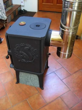

The straighter the flue... the better it draws...

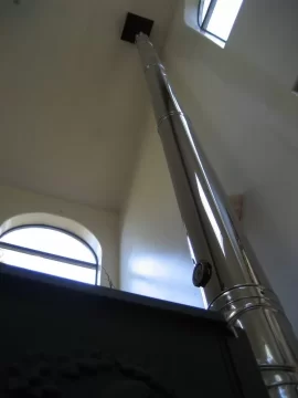

...and the easier it cleans.
