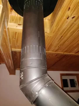

Can you post a couple of pictures of the setup? 300º on a double-wall stove pipe is high. A magnetic surface thermometer is for single wall stove pipe or the stovetop.

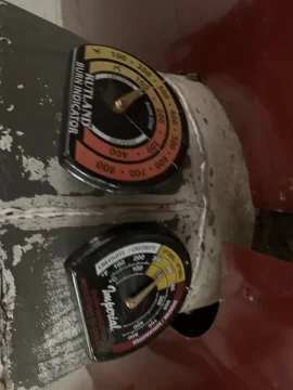

This is the thermometer : https://images.app.goo.gl/57LpoXU83bStZZYZ8

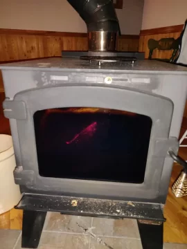

That's an odd setup. It looks like double-wall in the first picture and single-wall connected to the stove. Where is the thermometer?
The stove glass looks really black. It should be pretty clear with dry wood burning.
I've been moving the thermometer around to try different spots. I am pretty sure it's not working, earlier this morning it read 100f and the chimney was much too hot to touch. Presently it's on the chimney about 12" above the stove.
I blackened the glass yesterday, I was trying different wood to see if I could get the temperature up and the log I choose was too moist. Still have a lot to learn.
I’ve got 3 mag mounts and all 3 read different when attached at the same spot. The only one I’ve got that I trust is the auber with a thermocouple.
Hard to tell in the pic but one says 250f and the other says 400f.

I don't know what you mean by smoke being burnt. We have some white smoke exiting the chimney, and occasionally we get a little bit of smoke inside the house (odor, not visible.)
The inside the fire box is not smokey
I do now believe my thermometer is junk.

So, a properly burning stove will be clear in the firebox as it's so hot in there that the smoke is burning. When you light a new fire or the firebox is cool, like on a reload, you can see smoke.
