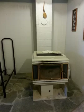

I am new to the site and first time poster. I just got a blaze king royal heir 2100 from a friend that was using it as a shop stove and have a few questions.. I grew up with with an old hurricane that was really simple so the whole combustor and bypass and all that good stuff. I started off by reading the manual and going through the stove, I feal like I have a pretty good grasp on running the new stove however upon inspections I had some questoins..
I checked the catalytic combustor to see if it was in good shape. and too my supprise it was all together missing.. So I have started shopping fot these.. With it missing I think I need to get the canned replacement combustor due to the fact that I dont have the tin housing.. would something like this work? http://www.stove-parts-unlimited.com/3-625-x-12-25-x-2-Canned-Catalytic-Combustor-p/cc-513.htm or are there better options?
also the handle for the bypass switch is missing.. I have done a little searching around and found this handle (broken link removed to http://www.hechlers.com/store/index.php?main_page=product_info&products_id=1062) but I think it may not fit my stove.. Any idea on a bypass handle that will fit a stove this old..
lastly I will be installing this stove into a pre existing chimney. it is an 8 inch pipe inside of a cinder surround.. the access into this is a six inch pipe.. Should I reduce the chimney from 8 to six at the stove and run the pipe up and 90 into the six inch at the port on the cinders. or should i run 8" up and 90 to the cinders and reduce it from 8 to 6 to make that transition.. With the second option it would create a smaller pinch point where it transitions into the cinder chimney with the pipe inside of it.. I know this options will cost more but will it really help..

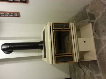

[Hearth.com] New stove to me "BK royal heir 2100" have a few questions Well I got it all plumbed and cleaned up to my liking.. now im just waiting on a few parts and only time will tell.. here is a picture of the setup..
Looks great! Hope it works great for ya!
Are you replacing the door gasket? From the first pic you posted it looked like maybe it was leaking..can see some black at the top left.
Good eye on the possible leakage hotcoals.. It looks to be in good shape but I will put it through the dollar test.. hey deleeper you said you had one of these.. does the blower have a snap disk.. I just wanted to make sure the fan works but I think I will have to wait until I have a fire or find it and put a heat gun on it..
