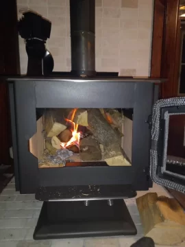

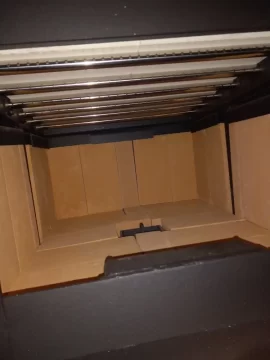

After our horrible house temps of 34.5 inside after the last cold snap we bought a new stove. It came on tonight. It's the vogelzang 3200sqft model. A 5 cubic foot firebox. This thing is a freaking monster. Took everything I had to get it inside. Doing the breaking burn tonight as it's warm out so we can have windows open while paint cures. Hoping she'll be a performer

Is it really a 5 cubic foot box? It looks pretty big but not that big. I am sure it will crank out some heat.
You need more floor protection Infront though.
According to its spec sheet its a 5 cbft firebox. I haven't measured. Yes was thinking of picking up a hearth mat for in front
Well yes but it's a spec sheet from us stove company. Just by counting brick it looks like about 4 plus or minus. Still a monster

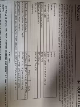

You could very well be right. It's rated at 152,000 btu. I thought I had read 5cbft. But it doesn't say that on spec sheet. I was wrong

It does look big. Lot's of secondary burn tubes. Your going to burn a lot of wood if your going to get that house warm.

Manufacture says firebox is 26" X 20.5" X 12.5" = 3.8 cubic foot, but then says 18" maximum log length in the manual. ? Maybe E/W loading? Heck... you could load a bunch of 18" logs N/S in the back, then put another 1-3 up front E/W.
EPA measured the firebox at 2.7 cubic foot. They probably enforce a clearance from the secondary combustors for fuel loading and standardize it across all stoves, so stoves with wide and deep boxes take more of a "hit" on measured size than tall fireboxes. There is some truth to that clearance and in practice it can be difficult to stuff a box full of wood when there's a bunch of pipes in the way.

Congratulations on the new stove. Is this the VG3200-P? If so, it's a 3 cu ft stove. I've been curious about this big beastie. Please keep in touch and let us know how it works for you.
Is the stepped heart surround framing wood or brown tile? It looks sharp, but if wood, my concern is that it doesn't offer the required 16" protection measured from the stove door.

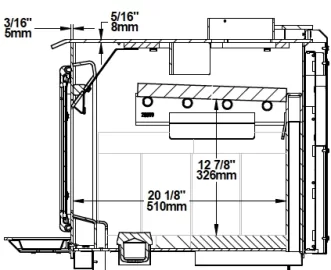

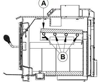

You're right, it's the Drolet HT3000 that shares the Osburn 3500 firebox. I got the models crossed.
The ht3000 has a stepped top. I don't think the osburn 3500 does. Perhaps internally similar. Idk.
just trying to keep things straight. Hopefully..
sbi provides detailed drawings for almost all of their line. It's a great resource for , well, details.
It's not a real step top, the rear deck is more of a fancy, integrated convection lid. The door hinge is the opposite too. The HT3000 has a vermiculite baffle and the Osburn 3500 uses C-Cast. Internally, the firebox looks identical. There definitely are differences in the trimmings and fixing between the stoves. I don't mean to state that they are identical.
