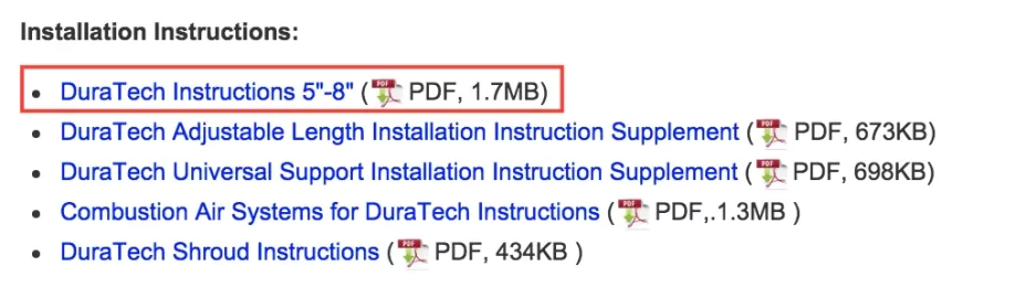

No Menards out here. They do offer a good value on chimney pipe that is hard to beat. For compatibility and ease of installation stick with one brand for all the parts of the system. Regardless of chimney pipe you buy I recommend downloading the DuraVent instructions. They are a good primer on installation steps.
(broken link removed to http://www.duravent.com/Product.aspx?hProduct=1)
Go to the literature tab. [Hearth.com] New Stove vs Used Stove?
