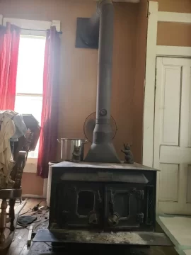

Wow, I looked up your stove, what a beast! A modern EPA stove of that size should have no problem burning for 8 hours or more and make more heat. You may find more free time to start improving your insulation and reducing drafts. Then you will use even less wood and stay more comfortable.

Old stoves required less draft than most modern stoves. This is because the flame and smoke path is longer around the baffle and because the draft has to pull air through the secondary air ducting when the primary air is closed down.

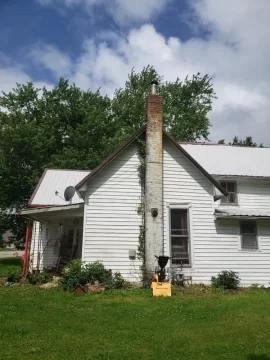

Tell us more about the chimney. Maybe post a picture of two of the current setup with the Squire. About how tall is it from the thimble to the top of the chimney? Does the chimney have a clay liner? Is it an interior or exterior chimney?
The chimney has no clay liner I dropped an insulated stainless double wall pipe down the center and it's still in great shape with no leaks, the draft is excellent, even with the damper closed if I crack a door open it sounds like a blast furnace, the current stove will keep the house warm but uses an ungodly amount of wood.

Even though you should get plenty of draft, I'd try to get the stove closer to the wall, to shorten that horizontal section. As you probably know, you can get the clearance and floor protection requirements from the manuals for any stoves you are considering.
