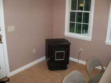

Picked up a 55-TRP-10 refurbed from ebay.
Installed in my sun room, lots of glass and very open to the house. Burned about a pound of pellets to test it - impressed with the ignition speed and heat output.
Corner install 45 with 7" clearance

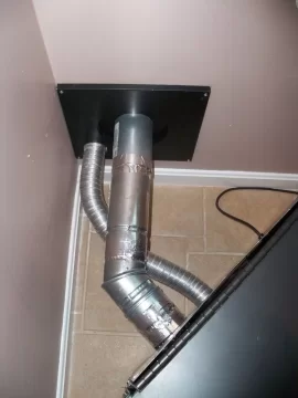

Ran the OAK through the thimble and taped each joint

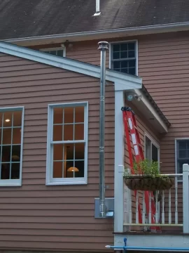

Can climb out the bathroom window to clean if I want - the T is 6' off the ground so it may be easier to clean from the roof. Pool is below so no leaf blower cleanings until it's closed and covered (water < 50f)

Very impressive install. I don't think you should have any need for the leaf blower when the pool is open. When I use the leaf blower, the soot on the snow only covers an area about 6x6. If you put the leaf bag on, there is very little soot to be seen. I usually like to be entertained by the "smoke monster".

Didn't think of the horizontal run - saw the double tee but didn't realize it was two clean out ports.
If cleaning is a pain I'll change it in the spring - my cleaning rods should be able to make the bend but fighting with them on a ladder is not my idea of fun (if I fall I'll land in the pool)
awesome install, good idea on the OAK through the thimble. :0
Oh I'm stealing that idea as I don't have a oak installed yet.

Nice clean install and venting - at least it's getting it above the nearest roof line - and will help to alleviate the soot buildup on the siding.

I actually got the idea from this product:
http://www.woodlanddirect.com/Chimn...ch-PelletVent-Pro-Wall-Thimble-Air-Intake-Kit
But being a frugal (AKA cheap) engineer, I opted for a $28 standard thimble and a hole saw. The stove came with the OAK so I wasn't about to spend money on another one. Took a little metal work to make everything fit right but well worth the effort.
If you are going to do it make sure to back the metal up with a wood block and clamp everything down really well. If you don't have a drill press that will go down to <100 rpm then use a cordless at very low speeds. Standard hole saws will cut sheet metal fine if you run them slow.

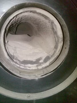

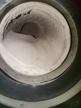

BTW
From these pics, would say the venting needs a little cleaning before the season? LOL

Holy Cow Don! I have never seen so much ash just sitting on the bottom of the vent!?!?!
Get that sucker cleaned ASAP. Have you looked into cleaning your Masonry chimney? Im sure there is considerable build up in there.
