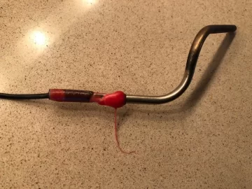

After 9 years of service my thermocouple on my Quad Mt. Vernon finally went bad. I replaced it with a factory part, and it worked fine for about a week. Then I noticed blobs of melted red plastic in the ash pan during clean outs. Started getting bad TC errors and stove shutdowns soon after. Pulled the new thermocouple, and noticed the plastic insulator had melted off the part. Why did this happen? Pretty sure I installed it properly!
[Hearth.com] New thermocouple fail on Quad Mt. Vernon
Have you had any misfires that would of put a fire in the ashpan? Only thing I can think of that would melt this. I do have a feeler out to see if any other issues like this have happened. Did a how to paper come with the thermocouple, explaining how it was suppose to be installed,esp. if a new hole needed to be drilled? kap
Have you had any misfires that would of put a fire in the ashpan? Only thing I can think of that would melt this. I do have a feeler out to see if any other issues like this have happened. Did a how to paper come with the thermocoupe, explaining how it was suppose to be installed,esp. if a new hole needed to be drilled? kap
No instructions. I think you're right, it must have been a fire in the ashpan from a too-slow startup, but this has happened before without incident. Must be my good luck this year with this stove. :confused:

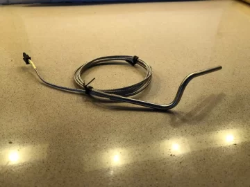

Well, picked up another thermocouple from the nearest quad dealer, the stove is running fine now.
Interesting, this version of the part has no red plastic sleeve. The wire is also twice as thick, with braided metal shielding around it.
Nice to know that I am part of Quadrafires R&D o_O
Anyway, the part number on the updated TC is SRV7034-247 if anyone is interested.
