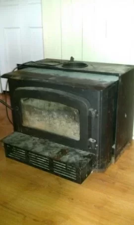

I know that this stove was designed as an insert. Would it be ok to use it without building a hearth around it as long as I follow all the clearance requirements? The previous owner had it installed in his basement but upgraded to a whole house system after 2 seasons so he gave me a great deal on this stove.
A couple pictures of the stove needs to be cleaned up a little but saving that for a rainy day.

Thanks for posting the pics, it makes so much of a difference when you ask for help.
I'm not that up on inserts and the requirements that they need. Legs? clearances? etc.
Other than my lack of knowing inserts, the stove doesn't look too bad. How old is it and if you don't mind me asking, how much did you pay for it?

As to your question, the answer is NO! I work for Drolet but the answer is the same for any brands of inserts, you cannot use them as free-standing. This has to do with safety regulation, UL testing etc... There's a pretty complex certification process for any wood burning appliances and each category such as 'inserts' have their own regulations & limitations. Not too mention your house insurance will not no longer be valid if you go that route.

Hi Jacob, I hate to be the bearer of bad news... An insert is only certified to be used into an existing masonry fireplace. Look at page 4 of your manual. "The masonry fireplace must meet the minimum code requirements, or NFPA 211 or the equivalent for a safe installation."
Again any Home/Insurance inspector would not certify the installation you have in mind.
For what you are talking about doing you need a 'Zero Clearance Fireplace' which is designed and certified for what you just mentioned. See some example here and download a manual and you'll see the difference. http://www.valcourtinc.com/
Unfortunatly, the least expensive EPA certified ZC fireplace on the market will cost about $2,500. Plus your cost of chimney HT 2100 which will probably be as much. Plus lumber etc.. for framing. It could easily turn into a $5K + project. If this is the way you think you want to go, jump in with your questions and we'll all provide you with valuable advice.
However, if you dont have a masonry fireplace I would suggest to clean up your Escape and re-sell it.
