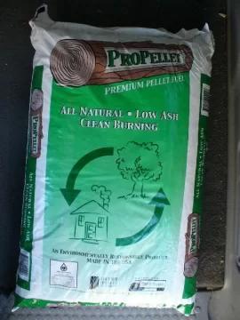

I keep my feed rate a hair below #2. That is with the "World's Best Pellets". Pro pellets.
I think the Grain cap helps keep some more heat in the burn pot for a better burn.
I do not use the stir rod with pellets.
