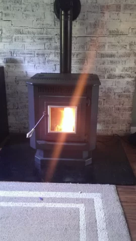

Well Scott just finished the install of our 25-PDVC and it looks amazing, he went above and beyond what was required.
That was absolutely exhausting. Very proud of it. First time I have ever punched through into the flue for an ash trap clean out OAK run. Ran a t off at a 45 then up the back for a true center line stack up the back. Notice how tight to the back the venting is using duravent...my secret how I get it that close for a true wood stove-like feel. All venting in 4" painted black makes it!
Of course it didn't start up right away. Had to pull the igniter plug and crank down the burn pot bolts...then she fired!
This is a very tricky install cause it has all of the difficult elements, full liner kit, masonry adapter, full lower venting set up and an OAK through 3 walls of brick and one wood frame. Took 5 hours labor and two trips out for venting parts and tools.
