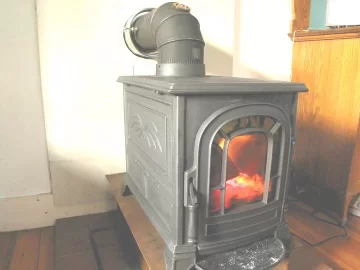

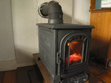

Do you have proper clearances to combustibles? The stove looks close to the wall, and is that a wood table you have it sitting on :bug: ????
Yes it is sitting on a wood table..... soaked in gasoline. No those are 8"' Steel I Beams. and the oak side table off to the side is 4' away. The photo makes it look a lot closer. The back wall is 12" away, the manual says 9"' is acceptable Heat shield and protected surface with 1" air space.

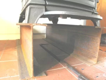

If you have time, take another shot of your installation and post it in the pictures section. Try to get it at an angle that shows off the I-beams. That is a novel approach. Pretty cool idea. Though knowing me, I'd bump into one of them in middle of the night.
The previous owner cut the legs short to fit in his fireplace. They work fine for me

That's good thinking with the beams. Certains makes it safe again.
I would be cautious of that set up on the beams. I know my stove has actually walked a little after several firings and cool downs. It would be a shame to have it unbalance itself that way. NO expert but that would concerm me a bit. One could always build a lip around the beams and weld them together with a cross section so they would be one solid unit. MY $0.02
I could strap them together. I ran a coal stove this way for two years without problem. I did get this on Ebay, the seller delivered for free, and helped me put it in its current spot. because he said he got more for it than he thought he would. I know i could have gotten brand new for about 300 more. he also said any problem and he would take it back. So far so good
You could just buy new legs too. Discount stove gets like 6 bucks a leg for the Aspen, if I remember correctly.

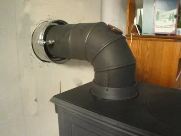

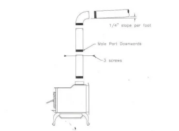

I few things i have noticed , looks like your pipe going horizontal is running down hill ? Maybe I'm seeing things ........a horizontal run of pipe should be going up hill 1/4" per foot of length to keep proper draft.
The steel I-beams is a very clever idea ......... I would also have them hooked together or bolted to the floor.
I photo shopped your pic's for detail.
First pic is the horizontal pipe run i had mentioned.
