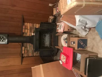

Hi Everyone! My husband and I bought a house that has a wood burning stove and we are really excited to use it, but a little scared. This is our first home and we know absolutely nothing about how to use the stove. Any info would be greatly appreciated!
I attached a picture of our stove. (Sorry for the mess, the seller is still cleaning his stuff out.)

Second, make sure that when you are ready to burn, that the wood is dry enough. 20% moisture or less is best. Good luck.
3rd use it as a fireplace only. 4th don't use the fan mounted in the smoke pipe above the stove you will have chimney draft issues with it blocking up.
