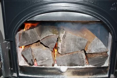

I'm a big F600 fan so I'll try to get to your questions.
1. If you're burning at 400+ you're likely burning hot enough to prevent too much build up. Hopefully you're able to check your chimney or have a pro come out and take a look with some regularity.
2. You explain your fire starting procedure. If that's all you're doing and starting from a cold start, you're not going to see longer burn times. On a side note, "burn time" is relative and for some is the time from the first match to the final coal. The time your fire will actually burn isn't much past a coupla three hours - at least from my experience. For longer heating time, you'll want to fill your stove as much as possible on the bed of coals your first fire generates. Also consider that wood species, split size, and of course moisture content play a major role in the amount of heat and "burn time" you'll get.
As for loading the stove, according to what I've read here my method is unorthodox. I load my f600 north/south. Yup, I open the front doors regularly. I'm not sure how other folks do it, but that side door severely limits the amount of wood I can get in there. I do use it for smaller fires and stirring the coals when needed, but otherwise I'm loading from the front. I also get a more complete burn from north/south loading. The pic is the stove loaded up for a night of sub zero temps - 3+ year pin oak. I get nostalgic thinking about that wood, some of the best I ever burned.
Also, if you're only setting your air at half, you're going to go through wood faster and losing a fair amount of heat. Continue to turn down the air in increments as long as the fire remains strong. You'll likely see the illusive secondaries with your air lower as well.
Hope this helps.

Last night, I tried schortie's method of loading north/south 8 splits from the front glass doors on a bed of coals. I think I loaded too soon because it flared up high and went fast up to 650F (that's the highest it went) and I panicked thinking I was overfiring. So based on what Nick Mystic says, maybe I didn't overfire after all, but it sure was glorious. I got major heat output as well, it went it up to 70F degrees at the opposite end of the room. I also got double burn time (4 hours!) than I had before, so that was awesome.
I consider burn time to be from when the fire goes on its own to when the coals aren't putting out any noticeable heat.
This morning, I tried pen's method of top to bottom loading. It worked ehhhh at first, I had to fudge starting a bit by adding more knotted newspaper, rearranging my kindling a bit, and then relighting, but now it's going great. With some practice, this may be a great way to go once I get the hang of it.
This morning I saw the secondaries after I shut down the air half way! Crystal clear coming out of the holes, at around 400F. Now it's comfortably burning at 450F and I don't see them anymore. I'm not getting the same kind of heat output though that I did last night. Do I understand correctly the first load won't put out much heat but subsequent loads will?

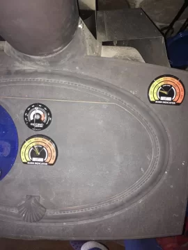

My stove's sweet spot seems to be around 550F-600F on the Inferno thermometer (see attached photo). This is where I seem to get the longest burn times and the best heat radiated out. The temps are not at ideal in the picture, but to show you what I'm using and where they are positioned. Interestingly, the center Inferno and Rutland are not showing the same temperatures and never do. Which one is reputed to be more accurate?
When I was worried about overfiring when my stove hit 650F (see above post), this was based on the Rutland center temperature. I had not put out the Inferno thermometer yet. Was that actually considered overfiring or no, given the placement of these thermometers?

I'm kinda partial to my Condar thermometer . . . mostly because when I measured the temp it showed against the temp registered on an IR thermometer they were within 50 degrees of each other -- not what I would call a precision instrument reading, but close enough for what I want.

I have 3 temperature gauges on my stove (yeah I know, overkill, but I'm still learning my stove): One Rutland in the back left corner, and an identical Rutland and a Condar Inferno in the middle oval. The one on the back corner is consistently 150F-250F lower than either middle one, and the Inferno is consistently 100-150 higher than the Rutland it is directly next to.

My stove's sweet spot seems to be around 550F-650F (center guage, Rutland).
I would trust the Inferno over the Rutland. If so it could be the stove is being run with a stove top temp closer to 750-800F. That's pushing the top end range and would explain the 4-5 hr burn time. What is the reload cycle like when the outside temp is 35º?

Hmm, the door isn't cracked open, it's wide open. The wood catches fire quickly, but takes a while to become a full-bodied fire. When I close the door, it's going really well. I never tried leaving it open just a crack.

When the door is cracked just a small amount you get a high velocity of air rushing in to fan the flames. This tends to push the fire into the rest of the wood further in the stove. That's assuming that you started the fire on the outer edge by the open door.
I try to start it as close to the middle as I can, lighting the knotted newspaper under the kindling using the top down method. Generally I light it in two places: somewhere on the paper maybe 1/4 of the way in and then again on the very outer edge by the open door.
I will try that, thanks!
