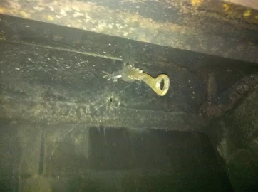

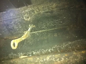

Looks like I can remove the damper but the measurements for the damper plate are 27" long by 5 3/4". Is it possible to squeeze the flex liner through that or would squeezing it affect performance? Not sure how much those pictures help out. If i take the damper plate off i would have a lot of room to the sides of the liner that would need a good sized back plate for both sides.

I'm new as well and currently working on installing the liner for my new insert. I have the same issue, a damper opening that's too small for the flex. IMO, cutting the damper to provide enough opening for the liner would be the best option. Pinching it through the opening is going to cause a large kink in the flex and will most likely effect the air flow a good bit. I'd opt for a cutting wheel on a 4" angle grinder, (with all necessary safety equipment), and cut enough of a "V" on the front and back of the opening to cleanly run the flex, (with insulation) through it. The 2400 is fairly large insert and I believe it goes back in the fireplace by a fair bit. As mentioned above, the location of the cuts may need to be more to the front or back of the damper to allow for a good angled connection to the insert. Best of luck.

Looks like you may want to take an angle grinder or sawzall to the center area to make passage for the liner.
