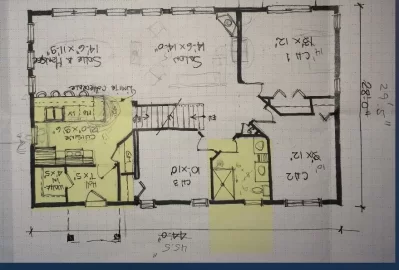

Hey addict welcome , could you give a rough drawing of the layout of house it will help the guys & gals to help you out.your basement is finished i hope otherwise about 50% of your heat is going to get sucked into the basement walls,if everything is insulated well and you heat 24/7 the heat will eventually rise up through house but it won't be as warm as the basement.you will also need dry wood around 15 to 20% the epa stoves live for dry wood.i assume being a cottage you have two floors if so it will be very hard to get heat up to second floor.

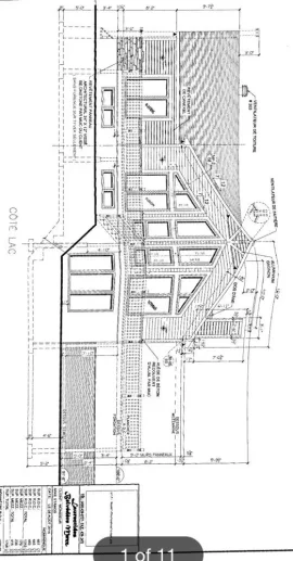

Hello Brad, thx for the quick reply. I have loaded 2 photos for you. One of the outside of the house with dimensions of each floor. And the other is to show you where the stove is located (basement under the beadrooms on far left of the house - when you are facing the pic)

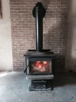

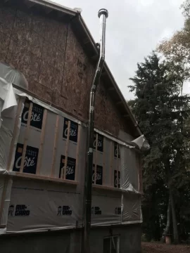

The basement is almost finished. It is insulated with 3" of monofoam and chiprock , ponted. Howver no floors are in (only painted cement) and ceiling is still open (plumbing and wires showing) The existing small wood stove is located under the bedrooms, the stair case is always open to above. 1343 sqft basement plus same size main floor and 400 sqft loft area, all open concept. Don-Bar fireplace located on mainfloor for ambiance only. 24' chimney is all exterier.[Hearth.com] New to wood burning [Hearth.com] New to wood burning

That looks like a Pacific Energy (Super 27?) and is not as old as you think it is. Should be an excellent heater for your 1300sq ft insulated basement with proper usage. Definitely not enough to heat the whole house, but the step up to the Regency probably wont be much of an improvement. If you can add a second stove upstairs that would probably be better
I have the super 27 which is the same stove unless thats a vista but I dont think so. I also have the same square footage and location of stove but my basement is fully finished living space. I live in a 83 build with 2 x 6 exterior walls and newer windows so that will have to be factored in. Had I known better I would have gone with the summit which has a 3 cf fire box for that extra muscle when needed. That being said Im able to heat my house with the super with the exception of the coldest days.
