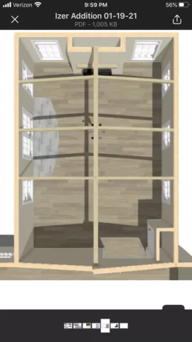

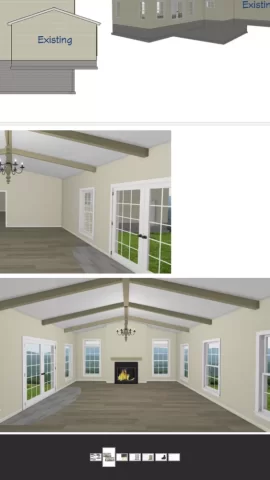

The misses has been finding pictures and researching on her own about the design. She’s made up her mind that a free standing stove sitting on a hearth. The black pipe (class A chimney please correct me I’m wrong about that) would be Exposed up to the the ceiling and exhaust outside above the roof. The background would be a stone floor to ceiling wall between the two windows. I added a picture of the room. The picture is designed with the original gas fireplace but you can get a general idea. You can also see the opening into the main first floor. One of our main concerns is overheating. As I said before we went to a stove store over the weekend. We liked the jotul f500 v3 oslo. Heating cap: 2300 sq/ft. Is a stove like this to big. One thought I had was to move our t-stat for our Heat pump to the second floor.
Great room drawing with gas fireplace

The flue pipe on the interior should be black, double-wall stove pipe. Class A chimney pipe will be what is on the exterior. That is usually shiny stainless steel.
The Oslo would be oversized for the room if that is all you want to heat. If the intent is to use the stove to heat more of the house then no, it wouldn't be too much. Plan on a ceiling fan in the room to help still up the hot air that is going to want to pocket at the ceiling. Or consider a window from the second floor opening to the top of the great room. That would allow heat to warm up the 2nd floor.
