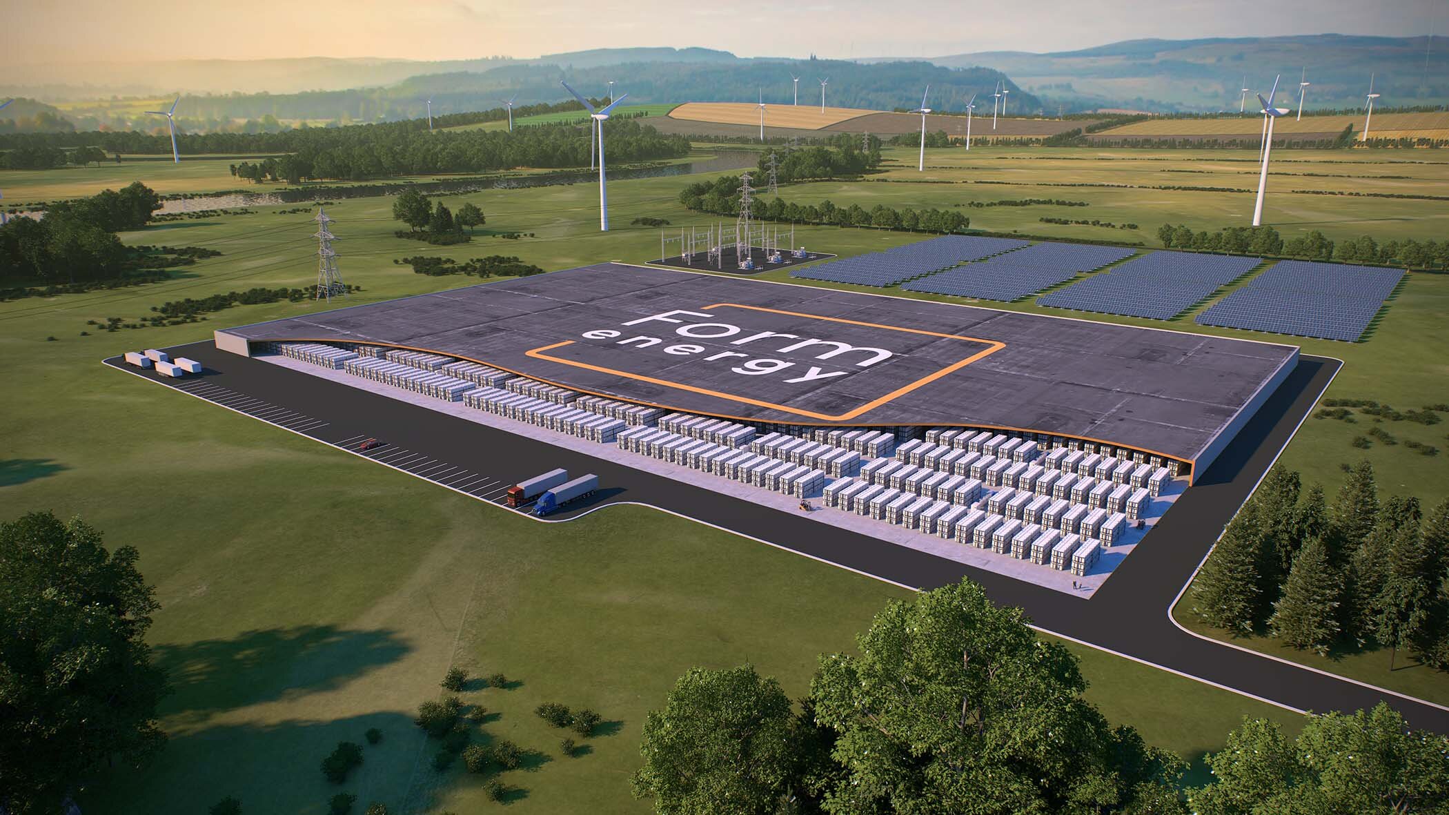

Also, I had to smirk a bit about the "acre with tens of thousands of batteries" providing 1 MWh storage. Volumetrically nice. BUT... Why put the solar farm on another acre next to it rather than on that acre big flat roof ...
Marketing imagery.
Sounds good. Not enough for me to put some of my retirement money in, but good nonetheless.
I wonder how this compares to the competing concept of flow batteries.
Marketing imagery.
Yes, that is a logical and practical way to install with a lower footprint.
