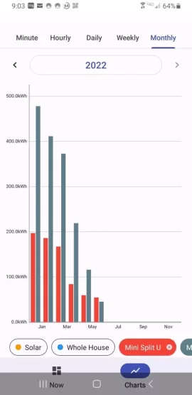

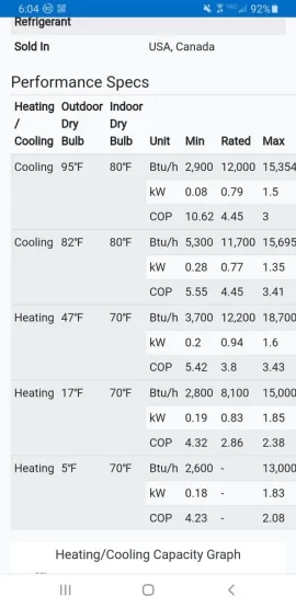

I don't think you and others realize how efficient a properly sized modern high seer 38-42.5 seer AHRI rated mini split heat pumps is. A COP of 3 for cooling is what a good Carrier central air unit was like 30 years ago. My mini split at its minimum compressor speed is rated at a cop of 10.62 cooling at 82 degrees using only 80 watts. I verified all these numbers with my Emporia Vue Energy monitor which is measuring voltage and adjusting for power factor. My observations were perfectly matched up with the below chart.
I have been on net metered solar for 8 years here in CT that covers close to 90% of my yearly electricity usage. I ran some numbers and even if I had to purchase the electricity these high seer mini splits use so little electricity that the savings over a central unit are massive. Most central air units are are around 16 seer.
Here is my yearly monthly electricity load on just both my mini splits that cover 90%+ of my yearly heating and cooling load. . As you can see my downstairs unit carries most of the heating load and my upstairs does most of the cooling. I haven't even used 100 kwhs this month for cooling so far which if I purchased the electricity would cost me around $26.
