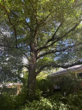

South ish facing roof tree will be removed. Peak production shading not an issue might be some in the winter after 3pm. Need to reall sight that in.

If your solar installer goes by the satelite pics, get another one. They are hacks and their numbers don't mean squat. Ask them at what angle the top of the tree is when viewed from the bottom of the lowest mounted solar panel. If they don't know, they're bullshitting you.
There are multiple trees in the pic, so cutting one down doesn't mean much. The sun in winter is low on the horizon...
*In particular with a string inverter* you need to have folks on the roof placing fisheye lens cameras at each corner of the proposed array, superimposing summer and winter solar paths on the field of view at those corners to truly calculate your production.
Did they even take into account the string inverter in their calculations?
They have lidar data in the model that guesses what returns are individual trees. I do want have the three remaining trees sighed in. Since I have a walkout basement the topography is in my favor.
okay, lidar is good. A fish-eye camera is better.

Can’t the the remaining trees until I remove the one next to the house;) I just got off the roof. Those trees will be an issue in winter afternoon /evenings.

Here is the tree that has to go. And a wide angle of how close the pines are to it. Some good fire wood and slabs there.

Bummer! Nice shade tree
Reactions: bigealta
Yeah but it loses leaves twice a year. And clogs the gutters every 3 weeks. The combination of leaves pollen acorns and pine needles will clog any gutter guard. I’m a bit sad. It blocks all winter sun from all but one window. It’s a 2-3k removal job. That’s at least 10% of my out of pocket cost. A significant expense. It needs a good trim now. It’s not good location other than pm shade on the patio.
