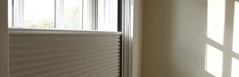

You have a pic of those blinds?
Reactions: stovexxx
Not off hand but here is a catalog cut
And most importantly the side tracks
I originally had a set without side tracks and there were a lot more air leaks.
They also have light blocking shades with hidden layer of foil in the fabric, Really nice when I had to work shifts and wanted a dark bedroom.
The other thing to order is the cord loop operators. They are lot more robust than the other systems.

BTW, they are not inexpensive, but compared to a new window or the adder for a Eurostyle triple pane, its less money with a high R value plus is far better dealing with radiant loss. The weak point on them is the thin cords inside the blind that pull the up the blinds. In the lower cost units, these cords are routed over tiny pulleys and then routed to the side of the blind through a friction catch and then are used to raise the blind. The cords tend to wear out and break. I have also heard that some cats will play with the cords and wear them out. I have also heard of cats climbing them with their claws, the blind material is fairly thin and i expect a determined cat may discover that they can poke holes through it with their claws. I have never poked a hole any of mine.
The blinds can be restrung by the shop who made them and there are websites that will sell you kits but I have tried to do it to a couple of my originals and its not as easy as one would think as a lot of the hardware is plastic and not really designed that robust. They can be shipped back but the shipping is costly and few people save the specialized packaging needed to protect them in shipping. The cord reel style, spring loaded or motorized ones with the thin cords not exposed seem to last longer as the cords are hung off a rod in the header of the blind and roll up on a shaft. There is no friction catch and they are far less exposed. The trade off is the cord loop style is not recomended for a home with kids around as they are a potential hazard. There is some hardware supplied to keep it tight and less prone to an accident but still is a remote risk.
The sidetrack option is definitely harder to find but worth it. The tracks are held against the window frame with a magnetic strip and can be removed. It makes installation a lot easier. If someone in the US has not taken advantage of the home energy credit, the extra cost for the tracks can be covered by the credit. (note most folks have long ago used up the cumulative $1,200 credit). I have always bought mine from the same place in Vermont, that I linked to as they are "made in Vermont" but I suspect they are assembled and customized in VT out of imported components. They were the first place I found with the side tracks option. I originally was looking for window quilts that were popular 40 years ago during the first energy crunch but there are superior and when pulled up there is little visual impact on the window opening.
