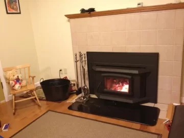

Going to invest in a moisture meter, great idea. Also like the idea of the BB's, but wouldn't know where to begin with that. I can see me losing a finger or two, trying to get the BB's out from under there. Im going to try and upload a pic, but keep in mind, it's still a work in progress. So here's my baby.

Welcome neighbor. That's a beautiful sight, no need to apologize.

Nice looking setup you have.
Welcome to the forum! You have a lovely setup.

Quick question for you, what is in front of your stove? a fire protectant rug? I'm looking at buying something similar for the front of my stove, but haven't found anything appealing yet.

It's a hearth pad. Think it's made of cement board. Our installer placed it as an added security measure. Just till I extend the tile. I kind of like it though.
