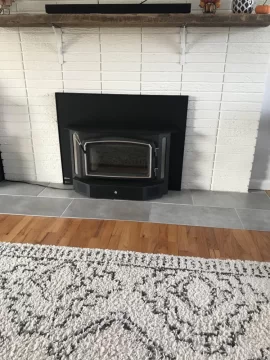

I have a Regency i2400 , I am in the 7th season with this insert. It does the job of heating my 2 levels house that total 1600 s.f. The secret is to have a good supply of dry wood. I cut and split end of March for burning starting mid fall 2021. I already have a good supply of hardwood, mainly beech that is 2 year old. Your climate would be similar to mine. The Regency runs 24/7 from october to early May. Change gaskets every season, a good sweep every 3 months and it is trouble free. You would not be disappointed with this make. I would not pay the extra for the i2500.

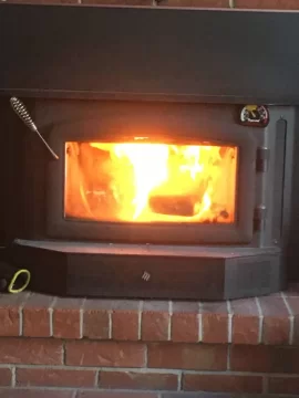

I purchased an i2400 this year and love it. It took me awhile to find an older version and not the 2020 certified one. If I load it up it would heat our 1,700sqft 2 story easily. I paid a little over $2,200 for mine so you are getting a pretty solid deal.
