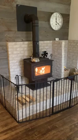

I’m looking for advice on a new wood stove that I’m planning to buy at some point in the near future (within a year or 2). I’m trying to do some early research and get some recommendations before I reach out to some stores in my area.
So, a bit of background… we moved into a house about 3 years ago with a Wood Pro 2000 (big box store type stove). It does a decent job but isn’t great at heating the house in the coldest part of winter if we have temperatures below about 20 or so.
For a while now I’ve been interested in the Jøtul v3 f500 and the hearthstone heritage. Looking on here I’ve seen a lot of negatives brought up about the Jøtul… not sure about the hearthstone. I like the idea of either cast iron or soapstone as it should provide a slightly more consistent heat than my current steel stove with lots of quick peaks of hot and cold. I’ve also looked a bit into the Pacific Energy Alderlea.
Some details on the house - build in 1920, renovated in 2018 before we moved in. I try to use the stove for about 75% of heating currently, but would like to get closer to 100%. House is slightly over 2,000 sq ft. I’ve attached a picture of the current setup. Hearth measures 45” deep, 56” across the back brick wall to where the wood storage cubby stars (70” all the way across including the cubby). With these dimensions I’m not sure if the Jøtul even has the clearances, but I think with the back wall being brick it makes the clearances ok? If not I won’t even need to consider that one anymore.
Sorry for the really long post, just trying to be detailed in order to get good recommendations. Like I said I lean more towards a cast iron or soapstone stove. Not sure if I even want a cat stove (both Jøtul and heritage have cats) as I work from home and don’t really need the super long burn times. Any recommendations? Anything obvious I’m overlooking? Thanks in advance for any feedback.
