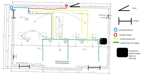

I have a brand new Model# DB03081 Drolet stove in the basement of my 1250sq/ft (with full basement, 1250 each floor) bungalow. It's a high efficiency home with R24 walls up and downstairs, and R60 attic. It keeps the heat amazingly well, but I'm looking at possibly using my 150cfm HRV to circulate air.
Here is a diagram of my exposed ducting in the basement.
[Hearth.com] New wood stove user: air circulation and chimney questions
I'd love to try use the HRV to circulate air from the stove to the house. My main concern is losing heat to the outside, maybe someone with better knowledge of HRV's can chime in. It's very easy for me to add an inside air exhuast above the stove (air sucker, same as kitchen/bathrooms) but just wondering if anyone else has done they same.

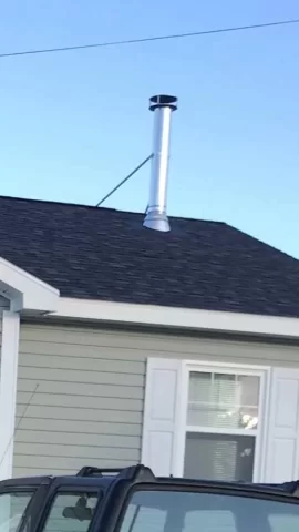

My second question is regarding chimney sounds. When the wind is coming north the chimney seems to vibrate sometimes, it's kind of annoying. Is there anyway I can look at reducing this? My chimney has a basic cap and rises a good 3 feet above my peak. Here's a pic:

As far as the chimney, next time it starts singing to you, I suggest taking the cap off and see what happens. Maybe a different cap design will help. If it's the whole chimney vibrating, maybe a tie between the roof braces would reduce the wiggle?
Not to code and your insurance probably won't permit it.

I’ll try removing the chimney cap and see. The directional type that work like a weathervane look interesting. I just can’t see how they’d last but seems to be poeple on both sides of that.
Even for adding HRV vents? I thought it was just cutting holes in the floor for circulation that caused those issues. What code compliant options are there?
The HRV can pick up stove room air as long as the air intakes for the HRV are >10ft from the stove.
