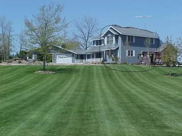

Thanks for the reply bgoodwithwood. Some of the layout of my house is quite open, The fireplace is centrally located, and ahead of it and just off of it on the one side are a couple rooms, and ahead and up there is a bedroom and a loft area. I'll post a picture, and in the picture is pretty much all the rooms I just described that are in the "open area". That amounts to around 1500 Sq Ft. The part I am worried about if I do an insert, is behind what you can see in this photo is the rest of the house, it is two story, mostly closed off to what you can see, I believe it's 15 ft by about 35 ft long. The only space there is between the two area's on the top floor is one walk in door. If I'd go with an insert, I don't think much heat at all would find it's way into that area. If I could find a company that offered the option of hooking up their fireplace directly to my forced air heating system ductwork, I'm thinking that would be the best way to go? So far, the only company that I found that will let you do this is RSF. The dealer that handles RSF in my area said he is new to their systems, but he feels confident they are a great system. I was a little weary because the brochure mentioned they were "EPA exempt". I've seen posts that mentioned EPA approved is the only way to go. Plus being new to this I was wondering why other brochures I have looked at haven't mentioned being able to hook into existing ductwork? The search feature doesn't seem to work for me but I have seen a few posts also where folks were happy with the Onyx but I just haven't seen where anyone has hooked up with their existing ductwork. Between that and just wondering how happy folks were with their RSF stoves were my main concerns. I would probably be looking at installing the Opel model assuming I went with this company.
Mark

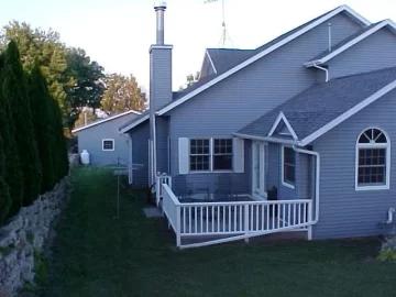

Here is one more photo, I'm not sure how good this will show up, but the part I have circled, or basically the whole area you can see that is two story on the right side of the picture, that's the part that isn't as open as it needs to be. That's why I was thinking it would be nice to hook into the existing ductwork. Make any sense?
Mark
