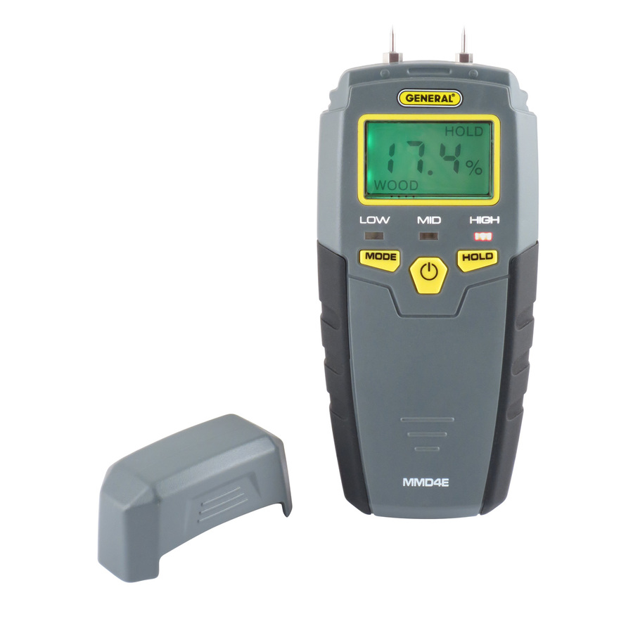

Hello, first time poster. I've been burning wood for about a year now. I have an open fireplace and I'm burning wood that was cut and split this spring. It's all I have available and it's not burning like I would like. We have enough spilt and stacked that will be ready for next year but I am wondering if I should just hang it up for the rest of this season or invest in a moisture meter and still use my fireplace. I just burn wood for the heck of it not really to heat my house. Love the smell and sound of it!! Is a moisture meter worth it or just let the wood sit for a year or two and forget about. Thanks

Your burning season is nearly over anyways. Try to have your wood split, racked and covered on the top only with a tarp. You should have good dry wood next fall a less it's Oak which can take a few years or more to season properly. If you do get a moisture meter, test on a freshly cut of wood, meaning cut the split in half and then test it. 20% or less is good to go. Welcome to the sight!

I picked one up for the local home improvement store (lowe's), best $25 I ever spent. I had some wood that was cracked and checked, and really looked and felt dry. Took a decent sized split and re-split it, inserted the pins into the freshly cut face......29%. I had been trying to burn that wood and it just wouldn't do right.
Some wood dries faster than others, so you can check each section of your woodpile and know what will be ready to burn.
I will never be without mine again.

Got one from harbor freight for around 12 bucks. Very small and fits in my pocket. It seems to do as it should. When this one bites the dirt I'll probably spend a little more next time but it's been good as a starter. It's helped me a lot from burning stuff i thought might be ready and wasn't.

I also have the $25 one from Lowes. Works great.
http://www.lowes.com/pd_78059-56005...l=1&currentURL=?Ntt=moisture+meter&facetInfo=

Funny thing is I was at Fleet Farm and noticed they have the exact same meter, but the yellow parts are red and it has an SBI logo on it, and they want $50 for it.

I just bought one of the Harbor Freight moisture meters, to check the firewood at our Ski Cabin. I compared it with my Lignomat Meter that I use for woodworking, and they were very close. $12 is a pretty good deal.
