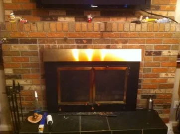

I have attached a picture of my current setup to see if there are any issues with replacing it with said insert, the only issue that i can maybe anticipate is the TV might be to close, but i could monitor that as we go.
Anyway, thank you for your time, and please let me know if you have any suggestions/ideas as to whether that's a good price for that insert, and weather it looks like it would work in my location.

Welcome to the forum Angus! If that insert is in good condition that is a bargain at $300.00! They still make that model and new it will cost over $2000.00..

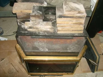

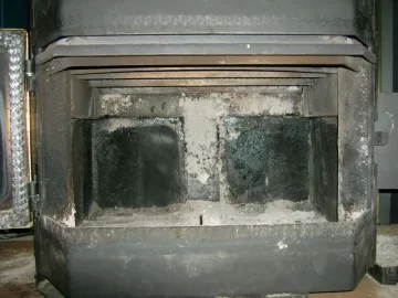

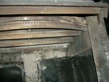

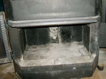

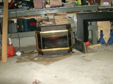

Ok, finally here are some pictures, its been busy with the holidays but finally found abit of time to take some pictures.
Is anyone familiar with this insert? One question i had is all online manuals that i can find, show it with 4 straight secondary burn tubes up top, in this on the front one is curved, and also shows curved in manual so i know its supposed to be that way, just seems weird as the model number stayed the same, on the side it is identified as an Osburn 2200.
I think at least to my untrained eye it appears to be in good shape, the fire bricks all look fine, not cracked etc. The glass definitely needs a good cleaning. There is a small amount of rust on the top but that will sit under the trim plate anyway, so I'm not sure if that is normal or not.
Anyway here are some pics..

Angus great pics and one hellava deal on that insert! The insert doesn't appear to have been overfired and in fact probably wasn't run hot due to all the creosote on the glass and inside the stove.. I'd be willing to bet that the insert was being run on wet wood! Once you get it all cleaned up and installed that glass will stay clean if you burn dry wood.. Keep us posted and thanx for posting the pics..
Ray
Wow, looks like you struck gold on that deal! Looks like a brand new door gasket...did you put that in?

No new Gasket, that is the way it came, so I'm guessing i don't have to change that quite yet then.

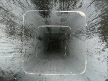

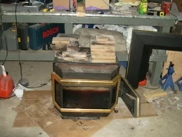

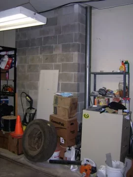

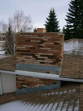

Here are some pictures of my chimney as well, i measured it at 10 X 10, I don't remember for sure but I'm fairly sure those were inside dimensions.
I plan on re-lining it with 6" flex liner, right now i need to do some reading if its worth it for me to go insulated as most of the chimney is in the garage where it never gets below freezing anyway.
I presume with 1 10 x 10 opening i should have no problem dropping down an insulated 6" liner though?

If you truly have a 10" inside measurement I think a 6" liner would fit in pretty well.. From your pic your chimney looks like a straight run too..
Ray
Do yourself a favor Angus, line it and insulate the liner. I went with double wall pre insulated rigid and it rocks!
You look sorta short on the height of the flue to start with. The insulated 6" will make her draft much better.
