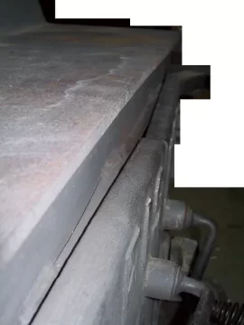

    See the attached pictures, which have been edited to hide all the basement junk which has accumulated around the cold stove.
    First off, the doors do not shut all the way, unless you really SLAM them. They touch each other about 4 inches out, but something flexes, allowing them to close, but not quite all the way. Is this normal / OK?

    I never tried to close both doors at once until you mentioned they hit. That is normal. They are designed to close the left door first and the right door overlaps it. If you close either door only, the door should close against the channel iron "door seal" flat, but not touch the plate steel stove front. (the doors only touch the door seal iron) They close easily, no slamming required. They should move effortlessly on the hinges. If either door doesn't close fully, (with the other one open) they are not aligned or centered correctly to contact the door seal. This is alignment when the hinge plates are welded on. No gasket is required or installed originally. Wire wheel all the old gasket cement off the door sealing area to close properly.
    The "door gap" you picture is the space between the door and stove front. It is not a contact sealing area. This space (clearance) is actually the thickness of the channel iron body (door seal) under the door at the contact area. The raised portion on the door contacts the center of the channel iron preventing the door edge from touching the stove front.
    Notice there is a groove cast in the door contact area for the outer "leg" of the channel iron to contact the flat door surface. The channel iron edge should fit the groove as close to centered as possible. Both inner and outer edges of channel iron contact the inside door surface, and the raised center portion contacts the channel iron center giving you 3 contact areas. With doors open, lift at the handle edge to see if there is a lot of play in the hinges. Also look for sag and alignment at door tops when closed. The left door should close easily making contact with the metal door seal, and the right door should feel the same when closed wether the left door is closed or open. They only interfere with each other when you try to close them at the same time. Don't do that.
    Hinge pins when dry and rusty require tapping out, sometimes PB Blaster or WD-40 and rotating them gets them moving. Once removed, they should be buffed on a wire wheel, greased and installed by hand. They should remove by hand as well. A Fisher door should simply lifts off the hinge plates along with the hinge pins.
