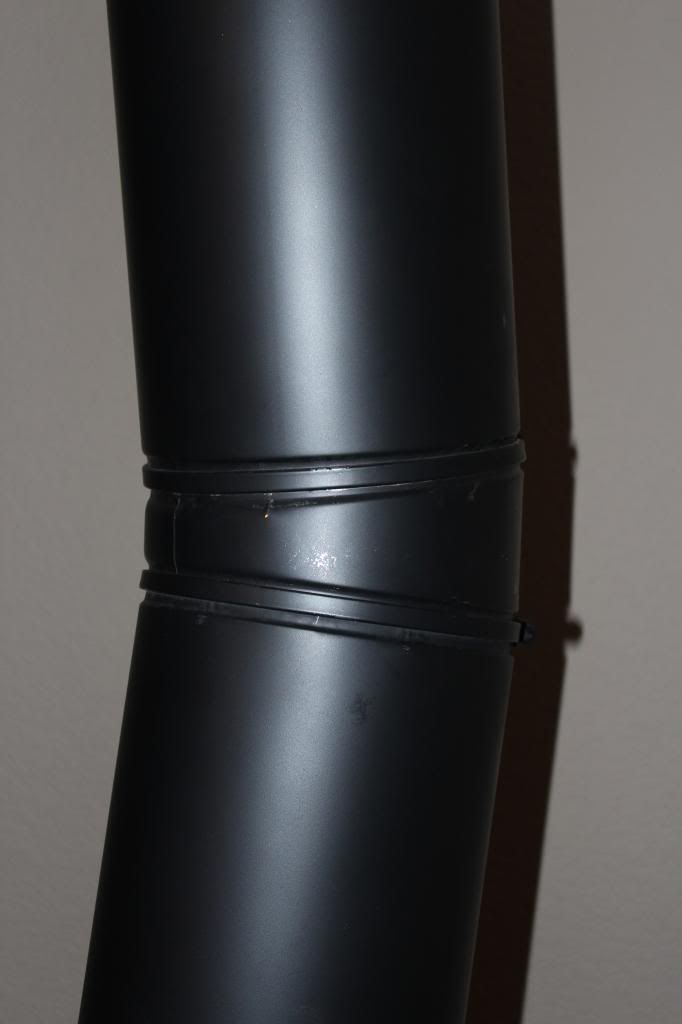

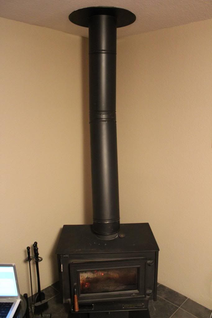

Hi all, I have a few questions. Pictured below is my setup.
Do the joints of this pipe require some type of buttle tape/sealant or just held together with the bracket and screwing together? The bends dont seem to be a tight fit. The pipe simply slides into the stove top with nothing keeping it there other than its own weight.

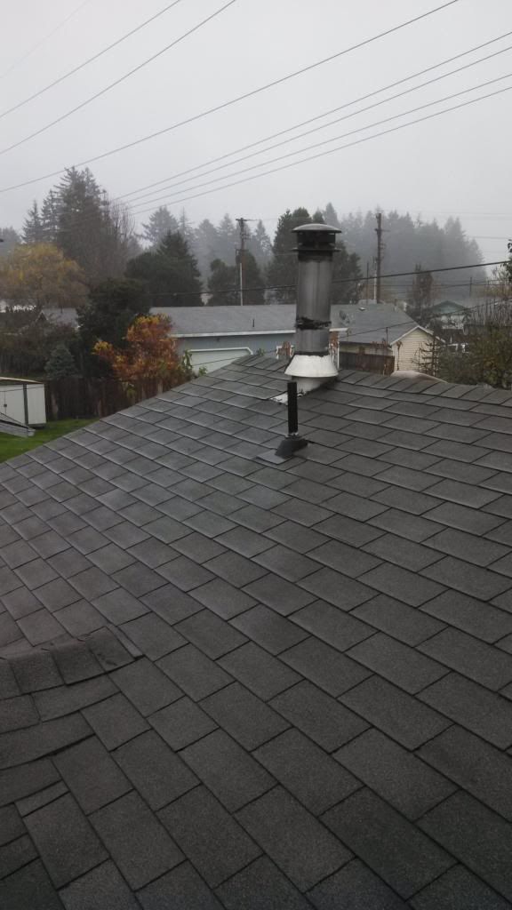

I am able to get fires to burn good and hot but no matter what when I open the door smoke will fill the room. Even with cracking the door for a while and the fire being hot. No difference weather a window is open. Pipe is clean and the chimney extends 4 feet above roof line. No trees near by.
Thirdly, I was thinking about swapping this stove for another that my parents have.(Nicer, Newer) Do they make an adapter that i could go from the double wall to single wall down to the new stove? Would make it easier to attach and cheaper.

All stove pipe should be connected with a minimum of 3 screws at each joint to hold the sections together. Sometimes folks will also smear some stove cement on the inside joint for a tighter fit. Stove connections may or may not have a screw or two or three to secure the pipe . . . sometimes folks without screws or screw holes will drill their own for the peace of mind.
Smoke issues . . . sounds like you're doing everything right. You say the stove is hot (how hot though is another question -- do you have a stove top thermometer or flue thermometer -- this would be helpful) . . . you've tried cracking the door a bit before opening it instead of just flinging it open. Assuming the fire has been going for a bit . . . at this point I would guess it is a drafting issue. You say the chimney is 4 feet above the roof line . . . is it 4 feet above the roof line 10 feet out? Also, what is the total length of the chimney . . . sometimes folks install too short of a chimney in a single story home and have some draft issues.

How dry is your wood? That blackened glass and smoldering fire in your picture suggests it is not fully seasoned. Burning wet wood could contribute to your smoke problems. Is that stove thermometer in your picture still working? What kind of temps do you see? Do you know the make/model of your parent's stove?

just a heads up. if it is double wall or any layered pipe you are not supposed to use screws. it is code in ny and usually will void warranty. not trying to be a know it all, it's just that this is an open forum and wanted to clear up some common confusion.

Just measured the chimney length: 13 feet. I was wrong, only 3 feet above the roof line.

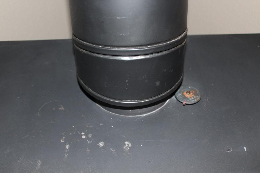

Hardware store had sold me metalbestos sealing tape. The stuff is smoking where it contacts the stove. Is that normal curing process? I also dont see where I could add screws. The long sections screw into each other and then a ring with screw to lock it together. The angle joints are held together by only the rings.

13 ft is pretty marginal for flue height. If draft is inadequate, it may contribute to the glass darkening and any other burning problems, like smoke. Having said that, mine is only 13 as well and is okay, but this model stove (mine) is said to breathe better than most. Some stove models actually require 15'. With all that smoke, I suspect you need more draft. Adding a couple of feet on top would help a lot if that's the problem.

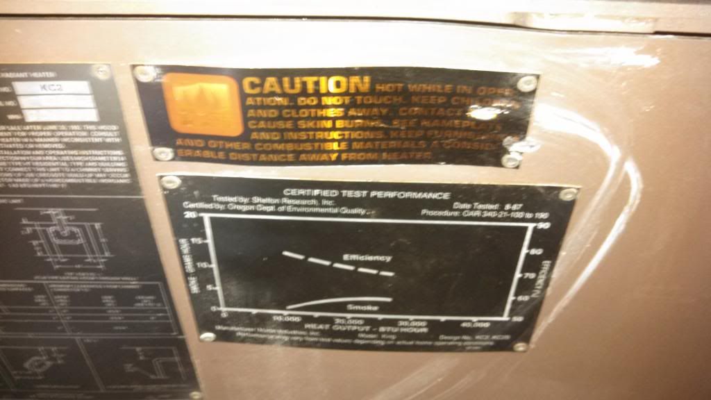

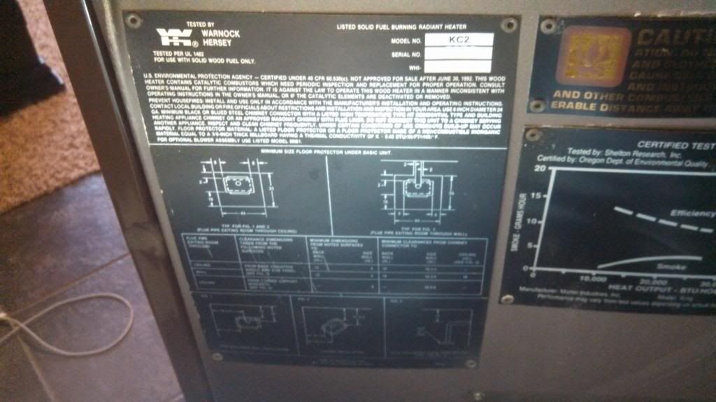

What kind of stove is this?
Does the metal bestos pipe need this sealant tape? First fire it was smoking but i dont know f thats just the initial curing process. I rather not use it if the locking bands are good enough.

yes, but this is CHIMNEY pipe. Dont add screws!
metal bestos class a w/locking bands all the way to the stove!
pipe looks kosher, stove clearance I'm not so sure about.
