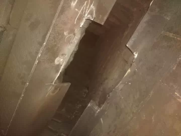

Installing a Drolet 1800 insert this weekend after I sweep my existing chimney (waiting on delivery of my kit from Amazon since the professionals are out a month with appointments). Flue is 13'6" from where top of the stove will be to top of the chimney, guessing another 6" with top plate and rain cap installed. Almost a straight shot down. Cut out the damper and clearanced the throat for the liner last night with a wafer wheel on angle grinder. Chimney is outside the chase and top 6' to 7' is 12"x 9" tile lined.... planning on insulating the liner with 1" kaowool. Anyone think I'll have draft issues? Planning on cutting the damper to block off up to the clearanced section, silicone seams and 2" kaowool on top of it as well as packing the remaining hole around liner with kaowool.

Yes I am going to lay kaowool on top of it, they use it at work and I have access to scraps/end cuts. Thanks for the input, too much ot these days to do this more than once. The liner will hopefully not be bad to get down...shorter length and one very slight offset. The fireplace smoked the house at startup and when burned down, has a large opening. Trying to burn a little less wood and not smell like a campfire all winter, lol

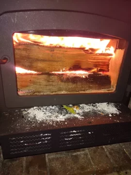

Installed this weekend, good prep and two friends got the liner and stove in the hole in 30 minutes, nothing left but the faceplate and surround after a couple burns to make sure all is good...44 on it's way to 32 tonight just loaded for the night and going to go to minimum in 10 minutes, already at 77 at the thermostat at other end of the house... stove lights, and burns awesome.

Keep the ash lip clean so that the blower doesn't suck in the ash and blow dust around the house.

Thanks for the tip, really easy install and really from the fireplace...1/4 the wood, 3 times the heat and no smoke or smell in the house.... really happy with how it draws considering my installed flue length from stove top to end of liner is on 13'3"
