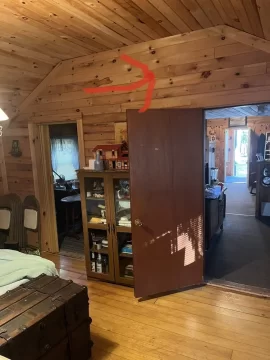

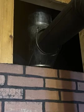

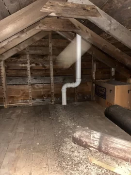

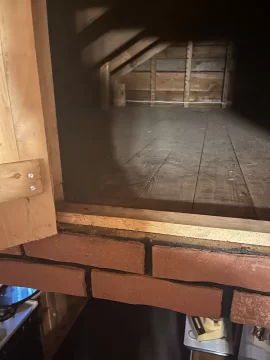

Hey all long time lurker here. So to begin, I’ve been inherited a cottage by my late grandfather in Eastern Maine. It’s roughly 750-800 sq ft with 9ft ceilings in the living room and back bedroom. The cabin is currently sitting on concrete footings and new vinyl windows through except the rear bedroom. There’s no insulation whatsoever currently but will be adding the recommended R value in the spring. Currently, the cottage has a very old Kineo Grand wood stove that needs replacing to modern burning. The living room and back bedroom with 9ft ceilings has ceiling fans to throw heat around so that’s a plus. I’m on the fence on what time of stove I should purchase. The old stove I have now has a little trouble reaching the back bedroom due to the layout so I’m thinking a convection type stove would be ideal. Would it also be beneficial to install a vent in the attic (as seen in the photos) to have the heat from that area flowing into the bedroom? Budget would be under $2000k. Any suggestions will be greatly appreciated by this newbie who’s looking to upgrade. Thank you all.

Looks like a medium sized stove will do the job. In the budget category look at the Drolet Escape 1800 and the True North TN20.

The Escape 1800 is a convective stove. With the blower added it is more convective. Howver, that may not solve the issue of getting heat to the back bedroom. In order to get the heat to convect there, put a table or box fan at the far end of the hallway, placed on the floor, pointing toward the woodstove. Run it on low speed. It will blow the cooler air down low, toward the woodstove room. The denser cool air will be replaced with lighter warm air from the stove room. Running this way you should notice at least a 5F increase in the hallway temp after about 30 minutes running. You can try this out with the old Kineo.
