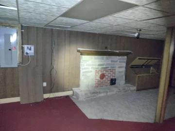

I didn't pull the chimney cap to look down it, but did inspect behind the bricked up fireplace, and unfortunately saw no metal stove pipe of any sort. Below are some added measurements and pics.
The hearth is 8" taller than the tiled pad in front of it.
From the tiled pad to the center of the 6" ID ceramic pipe it is 26" High.
The opening on metal door on the lower right hand corner of the fireplace is 8"X8."
I suspect that if 26" is too high for a stove pipe, that I can easily raise the base of a stove with cement blocks.
Question: If I were to install a wood stove, would I need to get the chimney inspected to determine whether or not it needs to be lined, or is it generally recommended that a liner be installed, given the age of the house (1975)? The liner matter is something I had planned on researching. Ideally, I'd like something I can install and clean/service. I didn't notice anything out of place with the chimney when I replaced the roof, fascia, etc., but I'm not one to gamble when it comes to safety.

It needs to be lined
I'll make sure to research the materials and prices before proceeding.
Somebody didn’t do you any favors with that brick wall.
There's no shortage of work to do there! I assume an easier solution would've been to simply have left the front of the fireplace open and run the stove pipe into and up the chimney, no?

A sledge and stone chisel can fix that.

You don't need a chimney pipe you need a liner

Buy once cry once. Personally I’d remove the added brick and install a new insert with insulated liner. I shopped used stoves for over a year. Glad I waited and got a new insert.
a look at Drolet 1800i. Budget about $3k for everything. True north TN20 would also be a good choice if they fit.
Good to know I only need the liner which looks to be a lot cheaper than the pipes! So, it's simple, single-walled, stove pipe and elbow connecting to a liner? Are chimney caps any different when using wood stoves?
I appreciate the suggestions for the new stoves and will look into them if/when the finances allow. My primary use for a wood stove is for entertainment and possibly supplemental heat on the very cold nights. The house is currently set up with electric baseboards and I'm toying with the idea of installing either a heat pump for the main floor (there's currently a working a/c with ducts to all rooms with the exception of the basement, where the fireplace is located), or multiple mini-splits for heating and cooling rooms on the main floor. I'm even ok with just ceiling fans, but the wife, being a wife, complains when it gets a little warmer. I'm moving from a townhouse to a detached with the front facing the East and rear facing the West so there should be good crosswind for keeping the house cool.
The remodel is going to be expensive, I'm not sure I'll have $3K+ to spend on a wood stove that may or may not be used all that much any time soon. I've seen a number of older wood stoves such as the Huntsman, Alaskas, Kodiaks, Jotuls, Fishers, Upland, Englander, etc. for sale locally online for anywhere between $250-$500, and some even for free (but unfortunately I don't have a truck or anyone that can help me fast enough before they're gone).
ETA. I could be wrong, but from my research it seems an insert is less effective at spreading heat to the rest of the house than a free-standing stove. Given that the fireplace, where the liner will run, sits underneath the two main bedrooms, I figured a wood stove 2'-3' in front of the fireplace would be ideal for providing supplemental heat to the three bedrooms in the main floor. I don't have any set plans for the basement and there's more than enough room for a stove.
